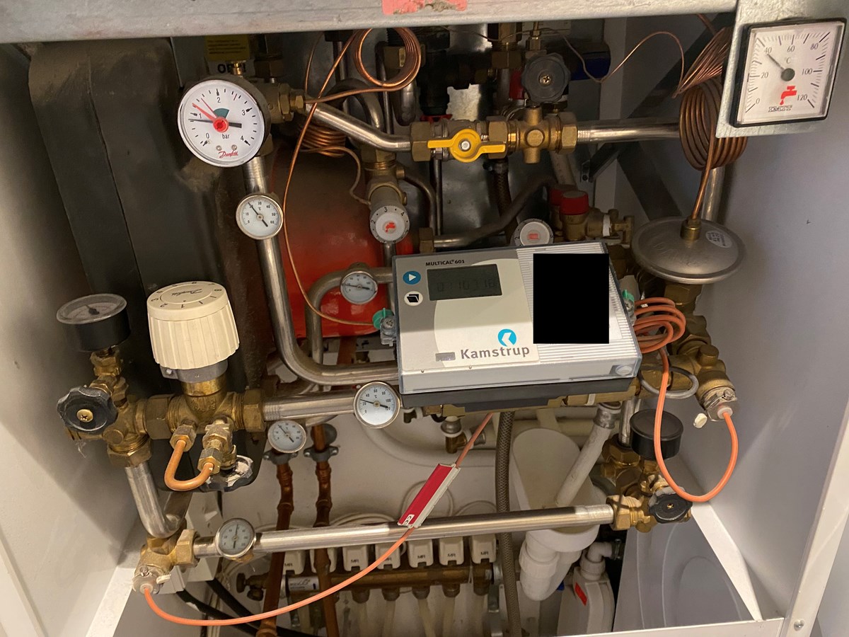

I have attached a photo of the heating unit. Not sure which one is regarding the water temperature? Is it the one on the top right with the tap illustration?
Thanks
Looking fine.
The thermostat (white round handle) regulates the temperature entering the floor circuit. The first gauge after the thermostat seems to show 28 degrees, which is the right setup for wooden floors. There’s another gauge showing the temperature when the water comes back from the floor heating which looks like 20 degrees’ish (picture is a bit grainy), which is also perfect, because it shows an 8 degree cooling of the water going through your floor heating.
So as far as I can see? Temperature seems to be fine.
Next step is probably looking into humidity problems?
