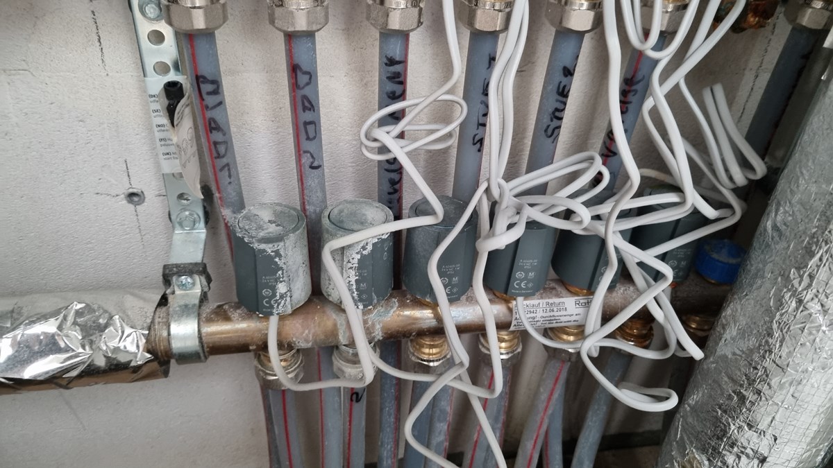

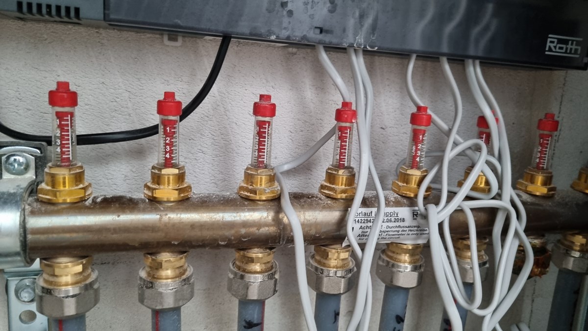

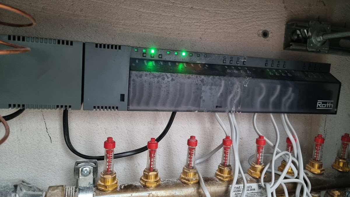

My next suspect is the floor heating. It's a Roth wireless system controlled by individual rotary knobs (not the ones with a display). They are all the way to the minimum, still the temp is at 25 at min, even when it's 10-15 outside or during the night. I read the manual but couldn't figure out if there's a way to turn it off completely or move to summer mode or something like that. Each "red pipe" is connected to one channel in the Roth (some share a channel) and they are divided by: bathroom 1, bathroom 2, room 1, room 2, room 3. The living room/kitchen is the hottest area definitely.

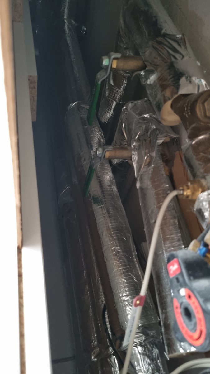

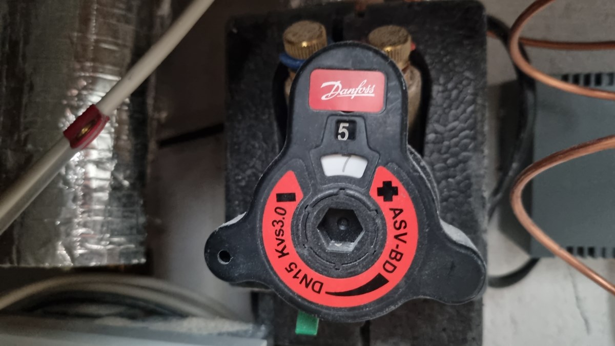

I also don't know what that red DANFOSS thing is for
Can anyone guide me? Here's some pictures
Try to adjust to a number lower than 5 try 2
 But what is it for?

 But what is it for?
 I think its for adjusting temperatur in the water for floor heating. You could take a look at the controler and thermostats.
If you google ASV-BD you will get an explanation.
 I'm not sure, apparently it's a "ASV-BD is a partner valve used together with the automatic balancing valve ASV-P/PV to control the differential pressure in risers." (from the manual). You think I should still try?
Do you have a picture of the regulator and cirkulation pump.
