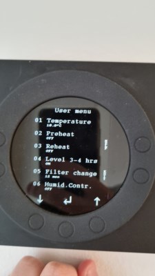

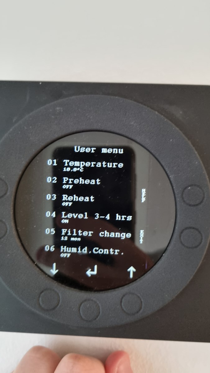

[img]https://i.imgur.com/7qkQM48.jpg[/img]
I've already turned all heating functions off, all thermostats are all the way down to the minimum (5). I tried setting supply and exhaust to 100%, supply 100% exhaust 0%, vice-versa, etc. None make a difference. And we are still sweating in here!

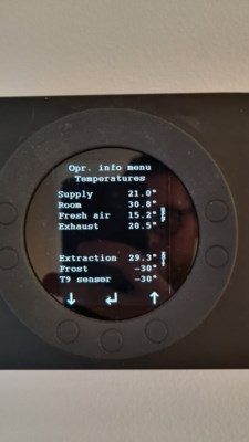

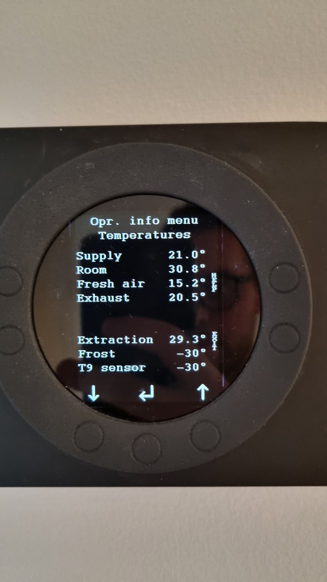

Just checked my readings
Room: 24
Outside air: 19 (my inlet is placed on the south facing side of a black roof, my #1 mistake!)
Supply: 21
Extracted:23
Most by-pass are not "perfect" by-pass. they just open up an alternative channel so some of the air still goes through the heat exchanger....
Hope you get this sorted, or else summer is going to be brutal :(

Something is not right if the external exhaust is reading approx 10 °c below the extracted air from the rooms. It should be close to the same temp if bypass or exchange  is working properly, as it is then the hot air from the room extract is being 'prevented' from leaving the unit.
Outside air is cold enough so a lower setting for the supply temp would allow the unit to blow in air at a lower temp setting - but could be felt as a slight cold draft after the sun goes down.
/BOFH

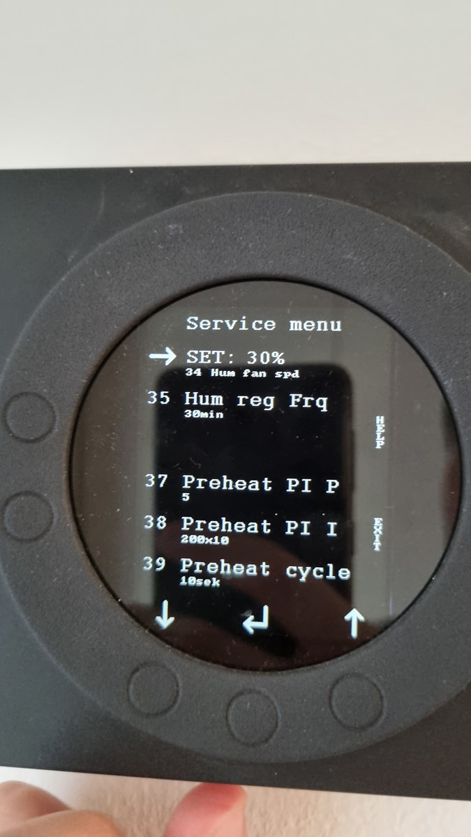

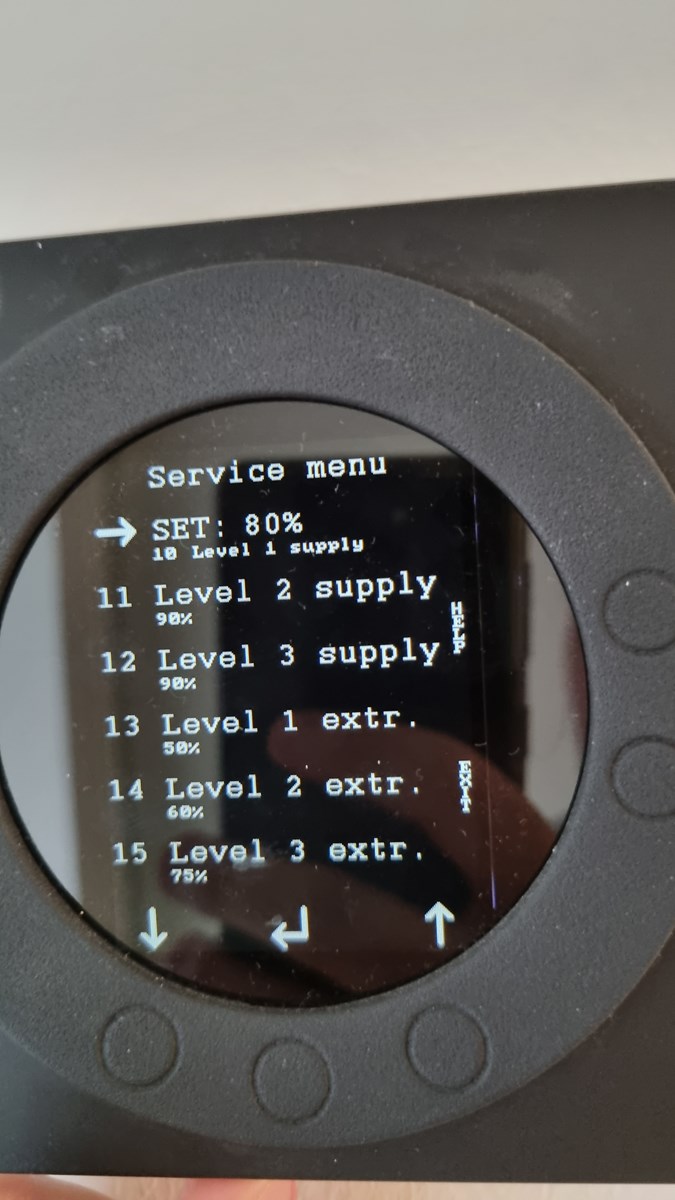

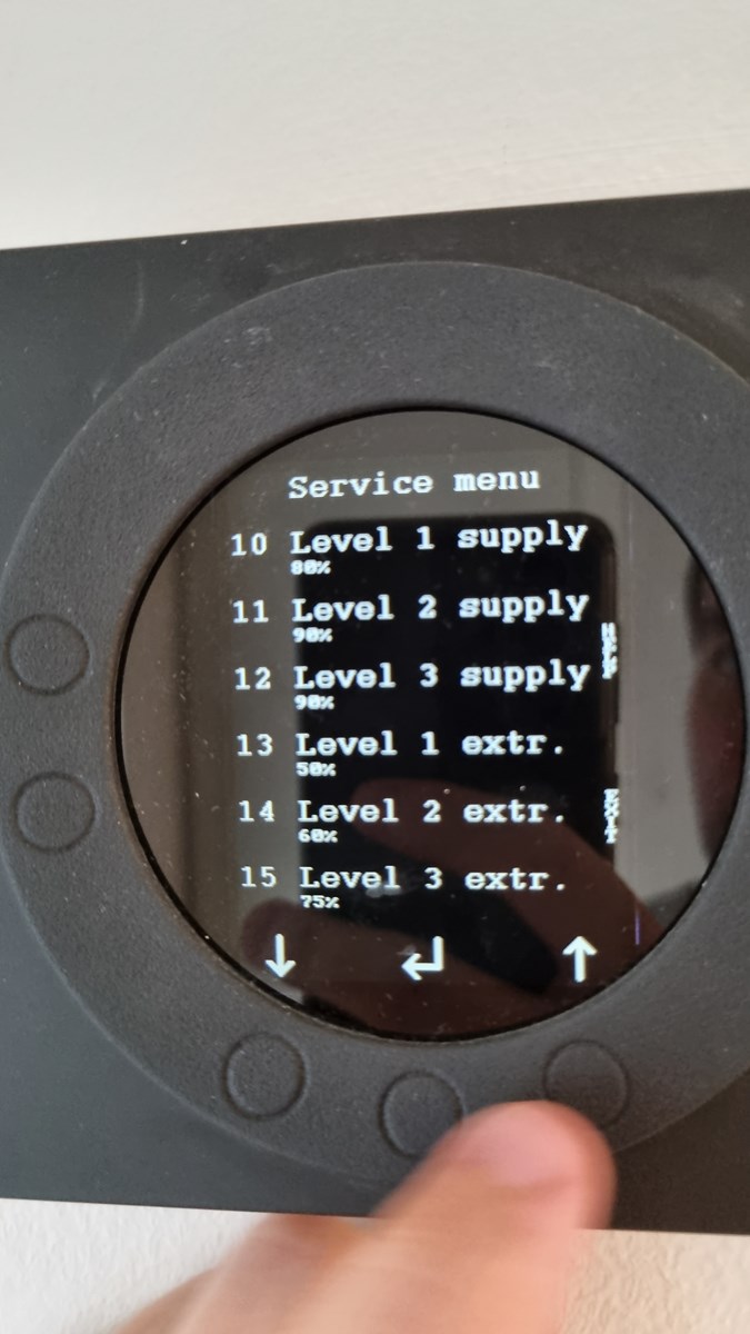

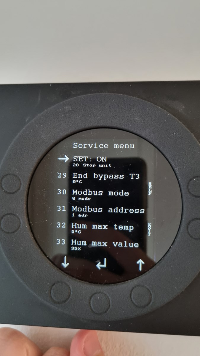

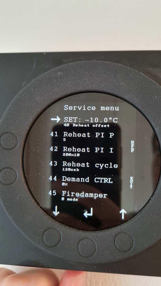

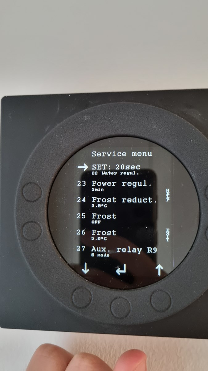

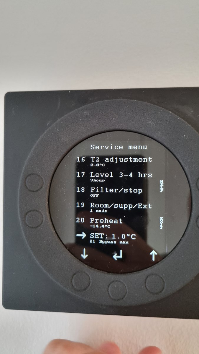

 These are my current settings (yes I've been messing with the level 1-2-3 % and honestly it doesn't seem to change a thing). Any suggestions to try?
BOFH
BOFH
2249 8600
The service-panel menu unfortunately does not improve the knowledge about the model of unit and its capabilities. There is some maintenance and service guides (with stuff you can do yourself) available at the genvex website, but which one to choose?
/BOFH
