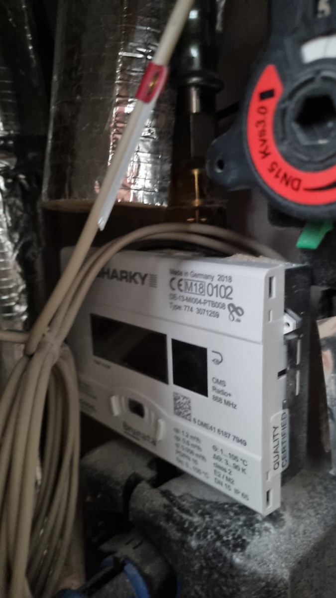

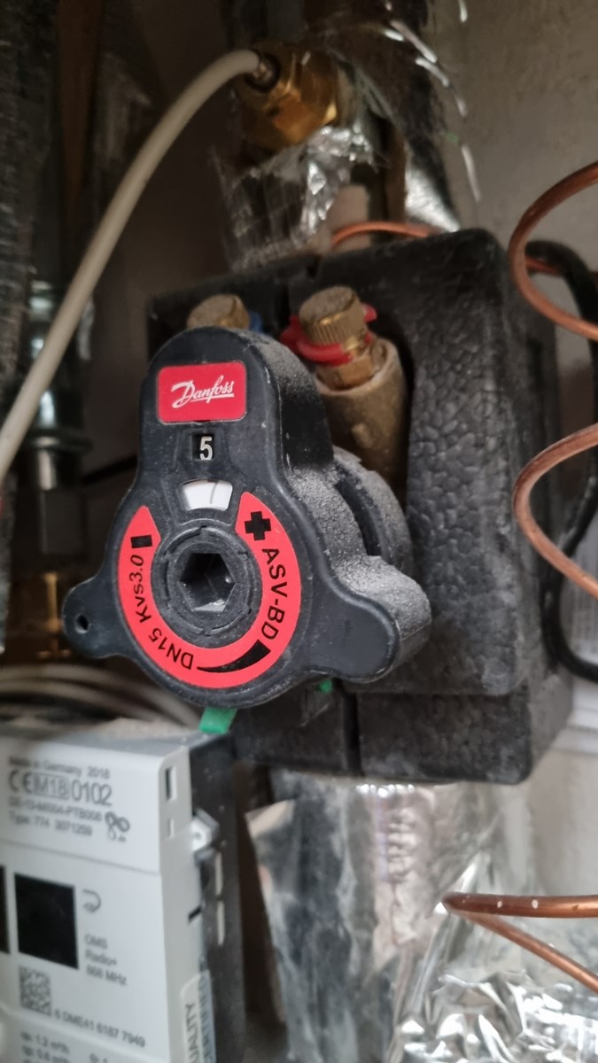

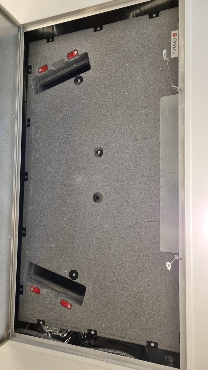

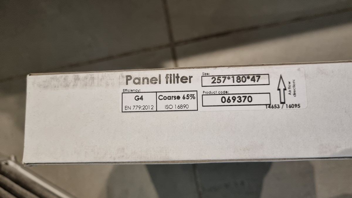

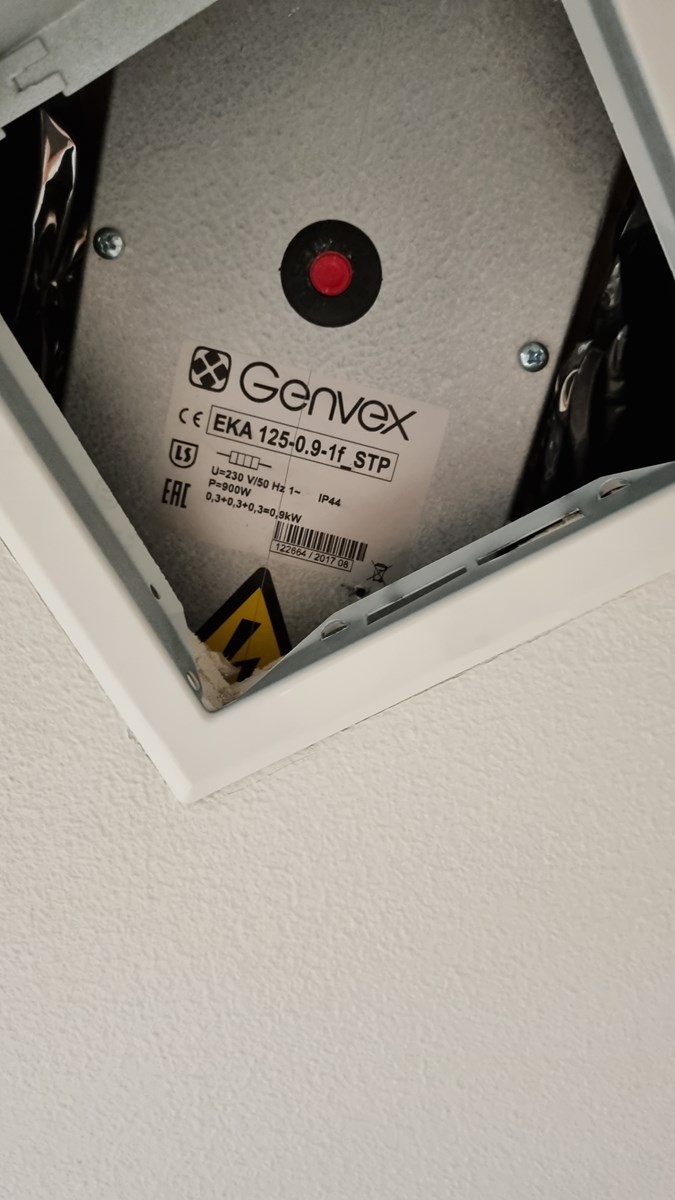

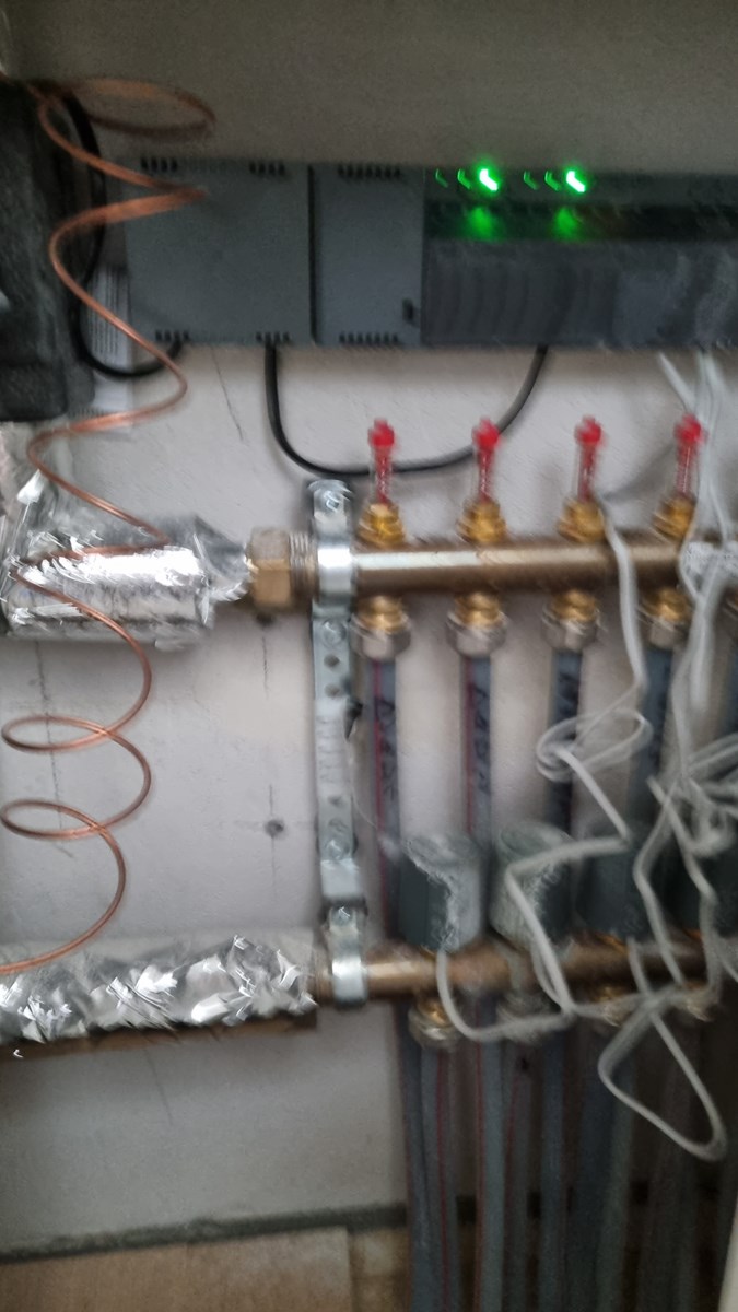

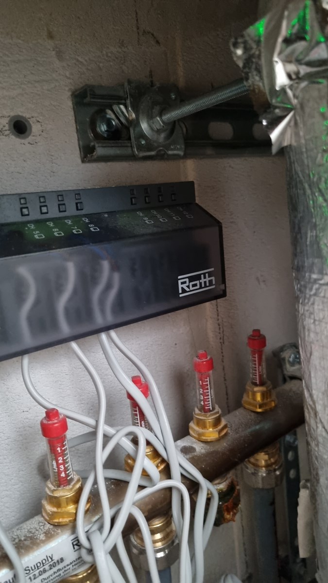

Hi guys, me again. Yesterday it was over 30 degrees in this fucking place, so I'm again trying to find out what the hell is wrong. These are all the pictures I could take of the genvex system (filters are pretty clean) and I'm also including some pictures of other stuff that are behind a wall, I'm not sure what they are for buy may be related?
#1. ''ve already turned all heating functions off, all thermostats are all the way down to the minimum (5). "
Are you sure thet 5 is minimum and not maximum?
efry skrev den 18-05-2022 14:42:07
 I did that on the Genvex controller, what you can see in this pictures is new to me, I've no idea what it is. I don't even know what that dial-slider set at "5" is for
any clues?

What's the "target" temperature set to? - Go to the default page - Then press the upper Right button.
To me it sounds like you've got the target temperature set too high, and then it's using a electronic pre-warmer or water based one to heat up the air, in order to achieve the temperature that you want.
