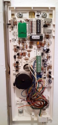

Jeg har fået tinnitus og kan ikke mere høre dørtelefonen.Kan lyden ændres?Telefonen er af mærket Videx.

F.eks. ved model 3171 holdes dør åbne knappen inde i 10 sec. hvorefter den skifter imellem lydene ( 10 forskellige) fortløbende. Man slipper ved den valgte tone og denne gemmes. Det hele uden at løfte røret.
det er model Videx 3171 model

To change the ringtone on a Videx 3171 digital intercom (part of the 3000 series), follow these steps while the handset is in standby mode (hooked on):
  1. Enter Programming Mode: Press and hold the "Key" (door release) button for approximately 10 seconds. The intercom will play the currently selected melody and then emit a beep.
  2. Select a New Melody: Press and release the "Key" button to scroll through the available melodies.
  3. Confirm the Selection: After the beep at the end of a melody, do not press the key for 3–5 seconds. The intercom will emit a confirmation beep, and the last melody heard will be saved. Videx Security +1
Additional Information
  • Volume Adjustment: The call tone volume can be adjusted using the 3-position switch located on the side of the unit (low, medium, high).
  • Number of Rings: The number of rings can be adjusted between 3 or 6, often requiring a change to an internal jumper (JP4) on the PCB. Videx Security +1
Note: These instructions are based on the Videx 3171/3172/3176 series manuals. Videx Security +1
Problemet er at lydfrequensen er før høj, så jeg kan ikke høre den, hvis jeg ikke har høteapparater på
