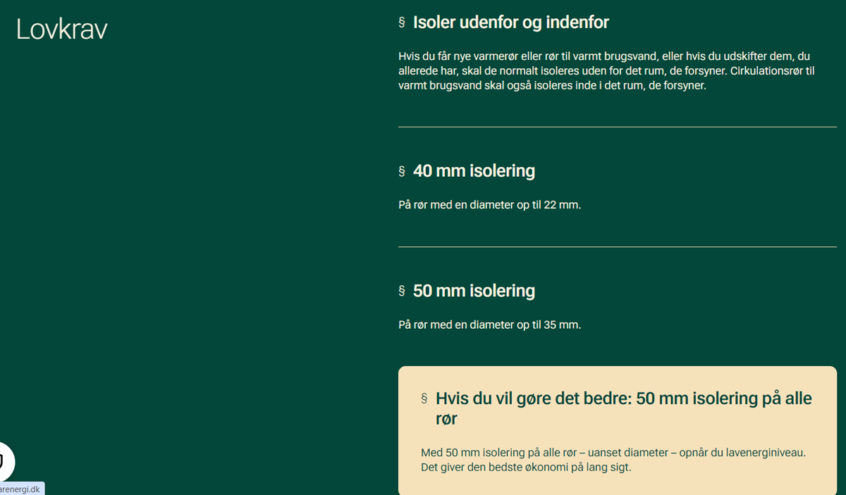

https://sparenergi.dk/privat/skal-du-renovere-din-bolig/isoler-dine-roer#:~:text=Hvis%20du%20har%20r%C3%B8r%2C%20der,ekstra%20isolering%20uden%20p%C3%A5%20eksisterende.&text=Dine%20r%C3%B8r%20til%20varmt%20vand,p%C3%A5%201%20dag%20eller%20mindre.&text=Det%20kan%20ogs%C3%A5%20godt%20betale%20sig%20at%20isolere%20r%C3%B8r%20i%20opvarmede%20rum
