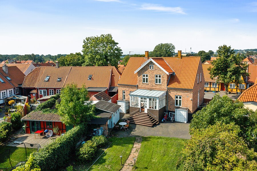

We recently bought a murermestervilla from the early 1900s. Three of the four sides of the house are in the original, untreated brick facade (beautiful brick as well). Of course, one side of the house had to be ruined by a careless previous owner at some point and is covered in puds and paint. The current owners do not know anything about it but clearly there used to be an entrance on this side of the house that was covered. I assume that's why only this one side is covered in plaster.
This drives me crazy since it's only one side of the house. I want to avoid plastering the other sides of the house as it would ruin the character of the house. I'd prefer to restore the brick but after speaking to one professional (he hasn't seen the property yet, I just showed him a photo) and doing some research, it's not as simple as I assumed. I figured one could simply sandblast the plaster off and done but now I'm learning the chance is high of ruining the brick allowing excess moisture/frostbite into the brick and it can crumble over time.
So, the question goes: are there any less aggressive methods to restore the brick? Is sanding/grinding an option or does that still ruin the burn skin on the brick? Even if it's a simple chisel and hammer and many hours of my time, I'm happy to do so as long as I am able to bring back the original brick facade. There must be some methods out there for this.

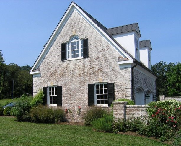

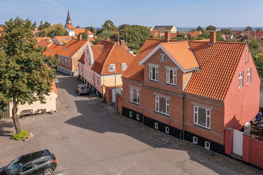

I'm open to different solution. I do feel it would be a shame to plaster all walls though as it would lose a lot of its character (for me that is, personal opinion as I know many don't like the look of raw brick). If it ends up being truly impossible, what would your suggestion be for a more aesthetically pleasing plaster work? Is it possible to create a rustic/worn look with lime? At the moment it's painted an unsavory red color that I really do not like. Attached is a photo reference with the south side of the house in red.

The other Guy is right. It does appear to be a very thin render, which is hard to get off. Sometimes it is Thick, poorly made and will become loose - particularly if concrete based  . No such luck here though . Well, you can always knock out the outer wall and reverse the bricks. 😓

@jenshøj Thanks for that. I talked to my contact earlier today. He said it was originally done due to moisture getting through the mortar. Sounds like it was more expensive/time consuming to properly re-point the mortar than simply plastering over the whole wall. That said, I don't really know and there could definitely be some surprises hiding under. Anyhow, here is a photo from the reverse side of the house. It should be red brick all around.

The bricks underneath are definitely red brick - not yellow - The use of less-valued yellow brick on the backside, was a thing in the building boom era between 1880's and WW1 - but only applied to large apartment units - and public institutions.

That said, are there benefits to “starting fresh”? Removing the plaster and then applying the thinnest possible layer of lime instead. My thinking is if I can achieve a lime wash look like something close to the attached photo then that could be acceptable. That would also leave the door open for the possibility of lightly doing the same later on the remaining sides of the house to match the look and still give me a little of the brick I want (or just keep it on the one side).

I think you need to risk some experiments. Start with removing the plaster in a smaller area like 0,5-1m2 and consider the result. An area that size is manageable to redo if you want to stick with the plaster(of course you will need to repaint, but it sounds like that is on the table anyway)
When you see the result of removing the plaster it is easier to determine viable options.
But also keep in mind that you risk ending with a less durable result. If the original wall was absorbing water then a damaged result after the plaster us removed will likely absorb even more and a thin wash with lime does not provide much protection from that.
