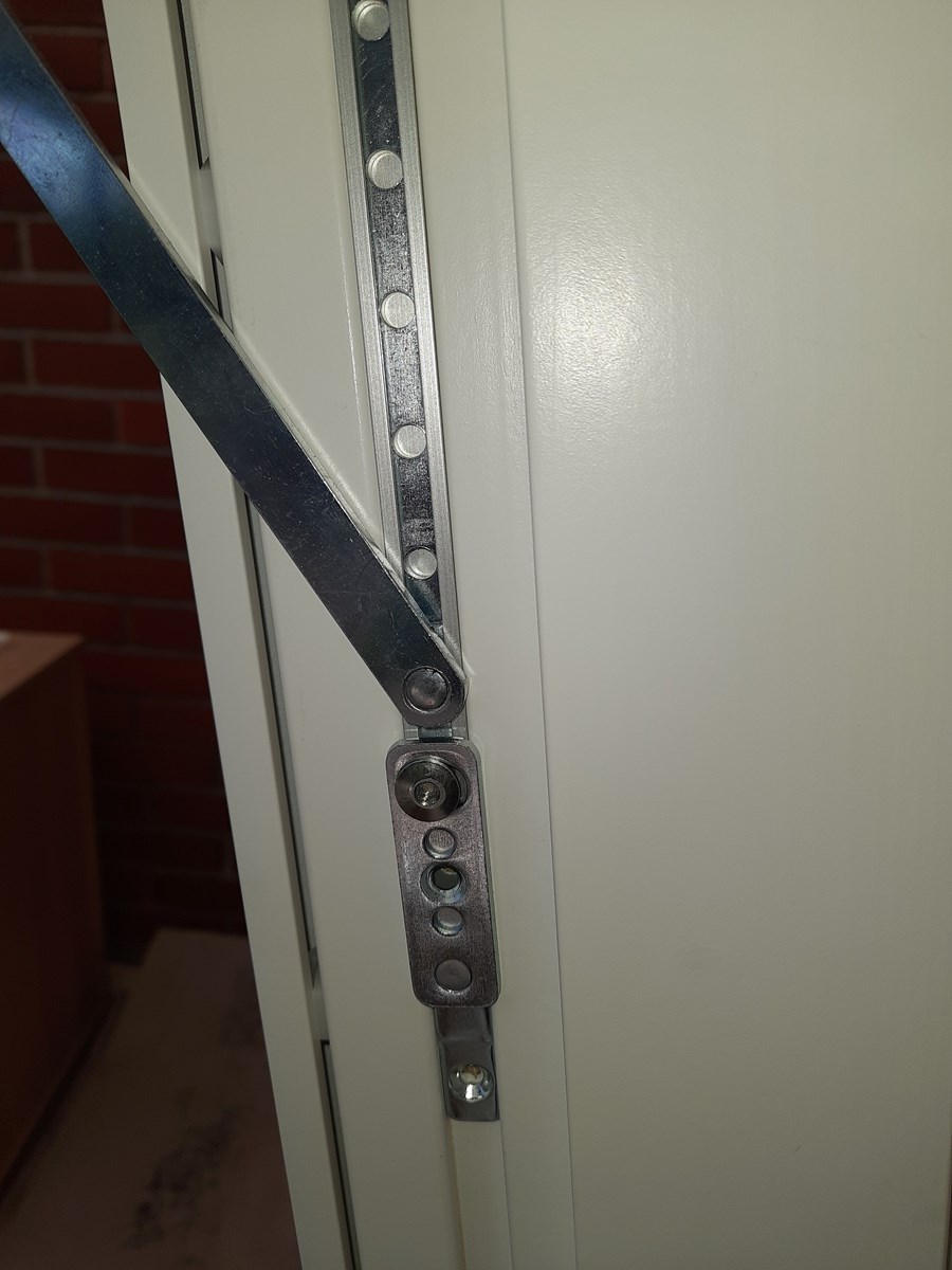

I got a new window that opens at the bottom and is hinged at the top. I would like to separate the frame from the window, since it is too heavy and inconvenient to mount as a whole.
https://www.sparvinduer.dk/vinduer-doere-restsalg/topstyret-vindue-1-rude-lager/

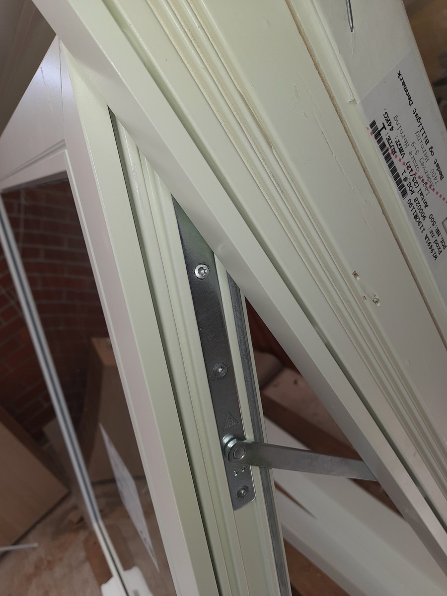

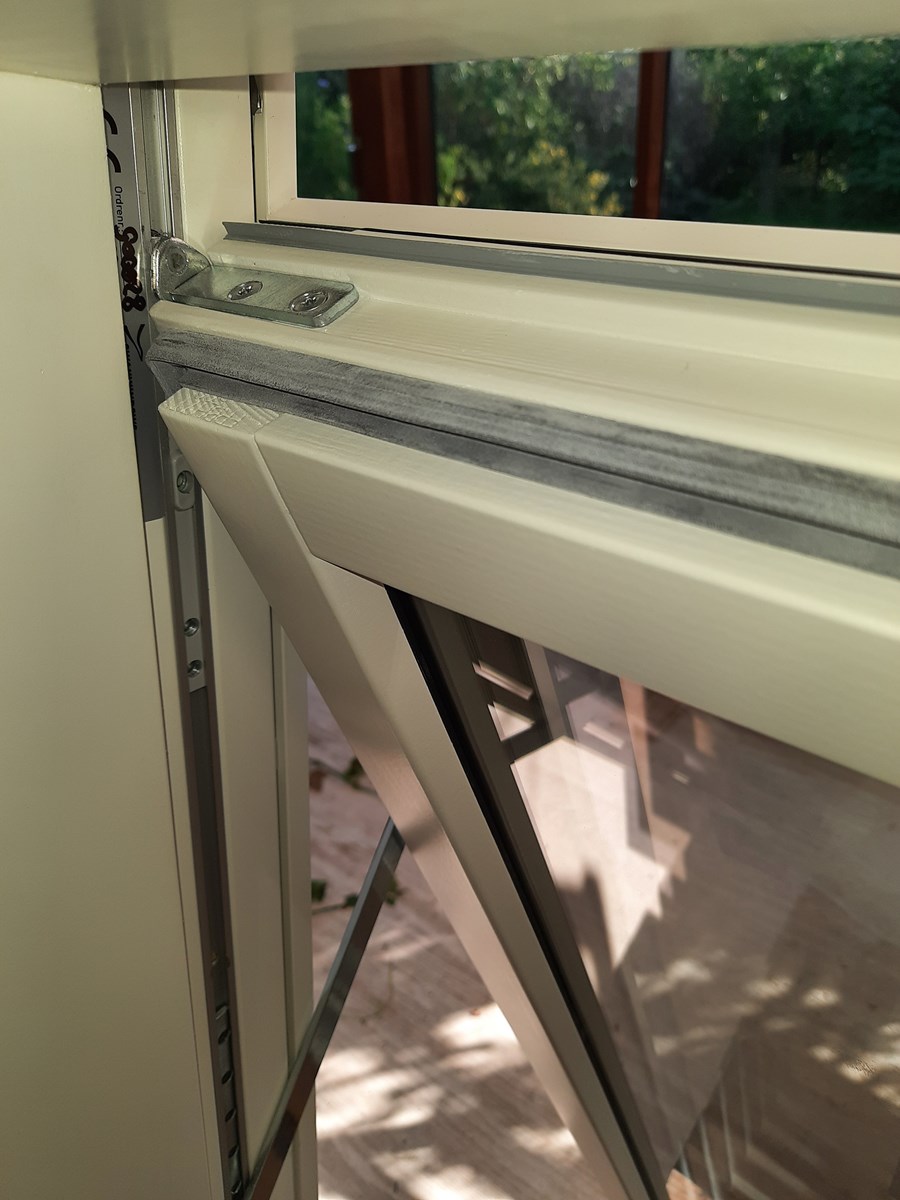

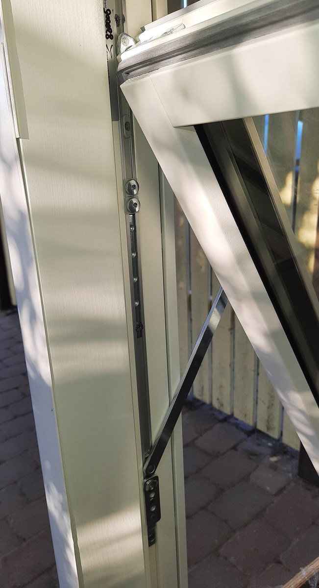

However, I am not sure how I can disassemble it or if I can do it at all. In particular I am not able to remove a particular screw [pic 3].
The last picture contains the original screws as they are
I assume I must slide it down the railing until it comes out at the bottom
Thank you in advance, I can also understand Danish if you prefer to answer in it but but my spelling and grammar leaves a lot to be desired
Det øverste billede. Du lukker vinduet helt op. skruer skinnen af som sidder i vindueskanten. Den kan være skruet også i toppen Når det skal i igen så er det godt at være to. Men det kan gøres alene hvis man har noget at lægge dt af på medens man skruer det fast igen.
