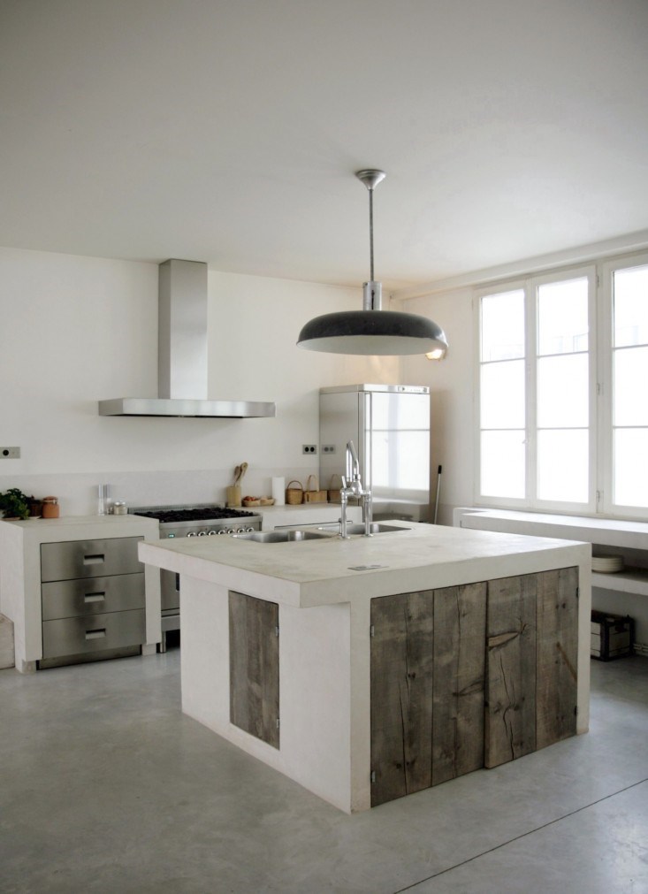

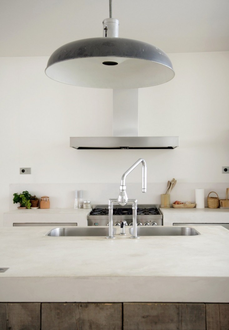

Im writing because I want to build a kitchen in a very Mediterranean style in my house and I have made a structure out of porebeton / gasbeton. Now I need to patch it opnå a smooth wall like in the picture below.
You have tried two plaster with plaster mortar but it was way too sandy and it was not getting delicious.
Can anyone help me with what material should I use opnå this result (photod below).
I have seen that some people recommend to use weber 280. But there are some spots that the porebeton is not totally matching (+ -1cm smaller) and I need to fill these spots with the plaster.
Thank you in advance and sorry for the English. It would take me two days two write this in danish :)
If you have this tolerance ( + - 1 cm. ) And you want the surface to be smooth og straight you must first give it a layer of lime mortar (kalkmørtel med 10% cement )  Then you can give it fine mortar or sandputty ( sandspartel )
