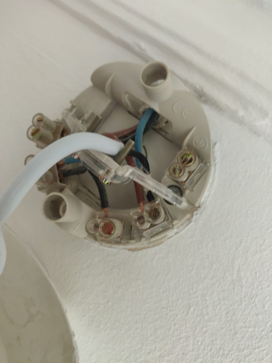

I've been trying (unsuccessfully) to wire a light in my apartment. The light goes on, but once it's on, it won't switch off, which is very frustrating. Have I wired it somehow incorrectly? See image attached.
My light has two wires coming out of it, L and N. The L is the black wire with the white tape on it. Coming out of the wall! We have blue, brown, and black.

Try to move L from your lamp to the connector next to the current one.
Also, when you get it working, remember to feed the White cable trough the strain relief on top of the bracket.

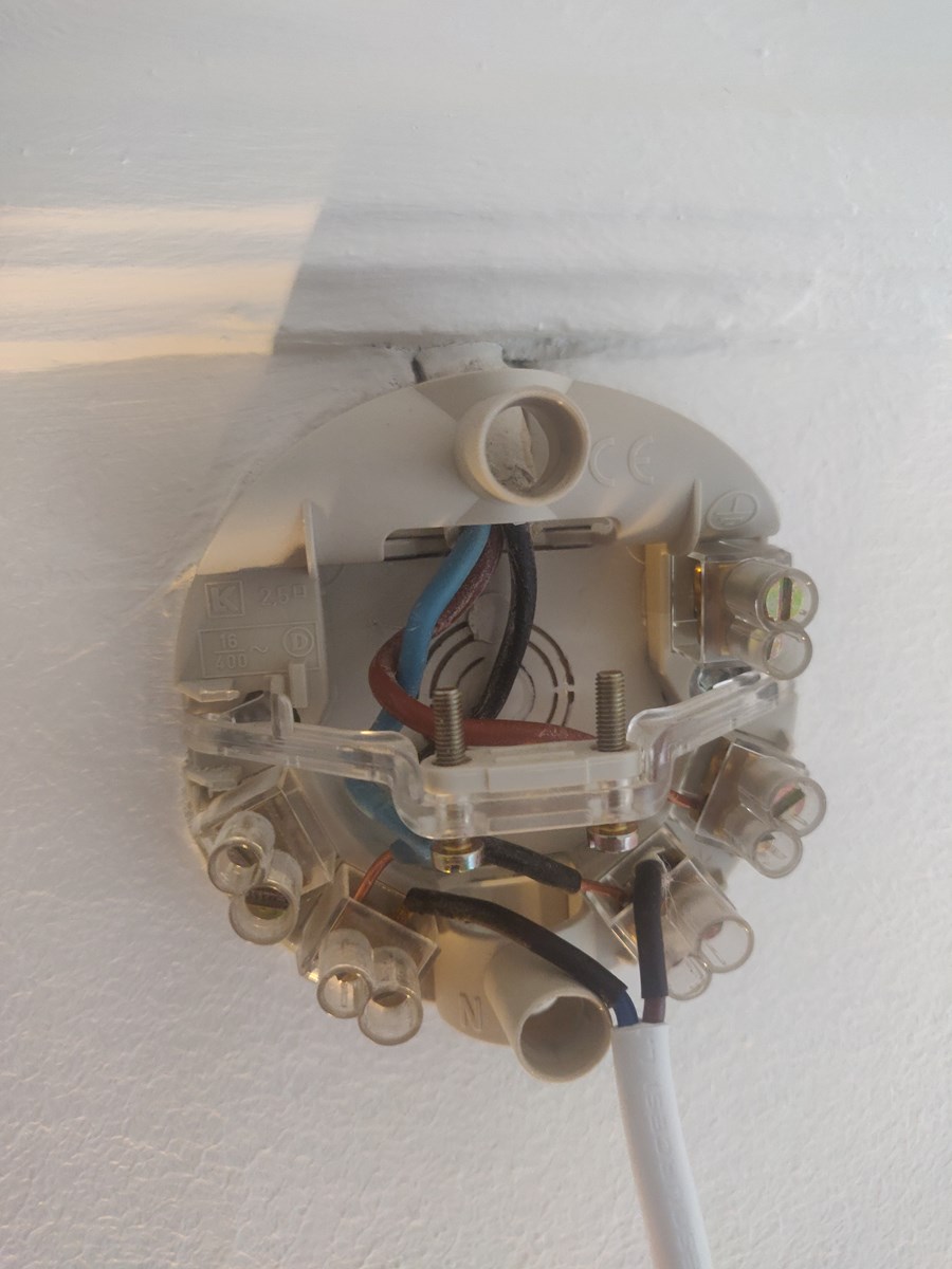

Thanks Greg, I tried it, and the light didn't come on at all this time. Is this what you meant?
And thanks for the advice on the strain relief, I had actually forgotten about that so good reminder :-)
Ok, so now you have one option left. Move N All the way to the right.
The color code in your house installation does apparently not comply with dk regulations.
Also, check that the solid wires are properly fixed and tight.
Remember to turn the light switch on each time you have moved a wire.
