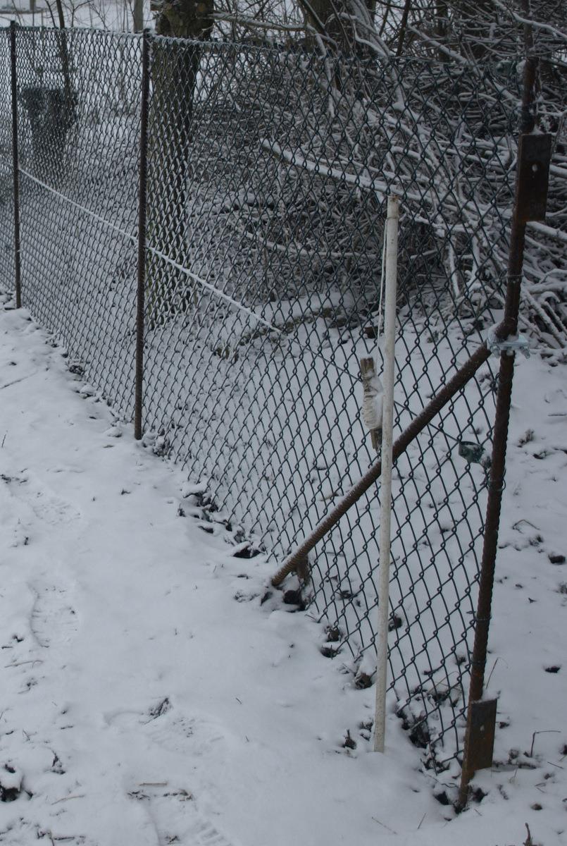

In the corner you must make it stronger, by doing a 45 degres post in each direction, where the force is coming when you tighten your wir fence. To prowend that the corner pole could be going up Again you may dig it Down with a small ancer under the ground.

In corners (Where you need diagonals to stiffen the corner) you may connect with "rørbøjler" http://lehaka.dk/u-boejler-varmgalvaniserede/
Tentorstål is not an beauty-solution, but it may be fast and you get a strong and flexible fence.
